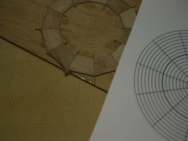

Something that seems to be helping me in my quest to build some segmented rosettes is polar graph paper. You can easily download freeware/shareware programs to print graph paper, and it makes checking angles, etc a lot easier for me.
Covered in wax paper or mylar, it's great for glue-ups.
If you print the paper with a laser printer (or dupe with a photocopier) you can iron the pattern on your workboard with an ordinary household iron.
If you use wide test stock when you are setting up your saw jig, angle errors will be more obvious- and a sheet of this paper next to the saw (and a bright light) will make adjustment faster.
Thanks again to Tony Karol and the other folks who've posted ideas about jigs and methods for building rosettes.

Interesting, Thanks John, good trick
Here is one program that seems to do the job.
Graph paper printer
